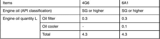

arturj123 - 04-06-2013, 21:59
4L + to co wejdzie do filtra (ok.300ml).
http://images49.fotosik.p...ca0a9bb1a6.jpeg
