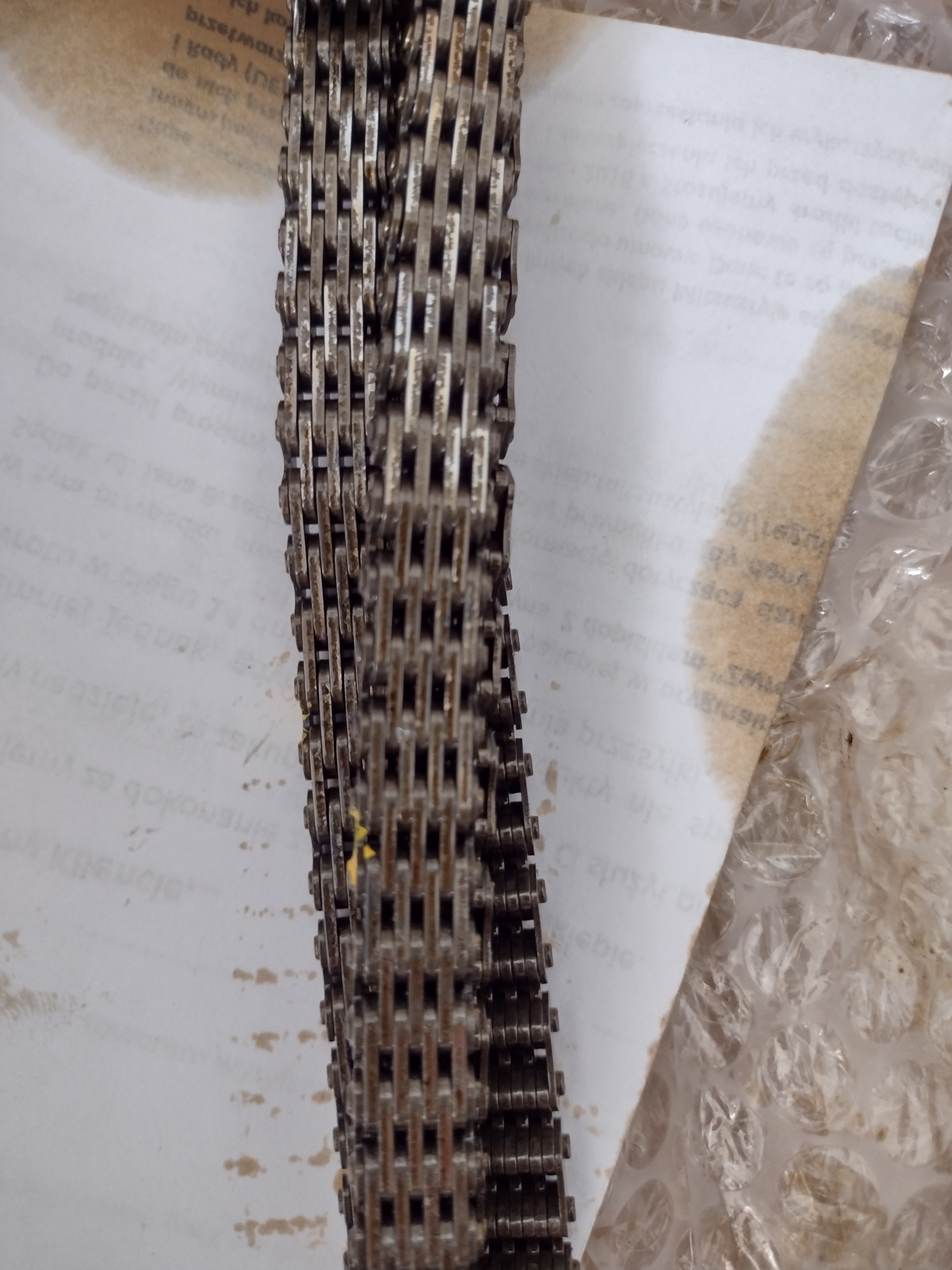

I left the car to my mechanic 2 days ago and just got it today and I will summarize for you what he said:
-He mentioned that the old timing chain was not in bad situation however it stretched a little bit when he compared with the new chain, I think its normal after 150k km. Here is the old chain:
- The tensioner was not doing its job anymore and he said that I was lucky as the chain has not jumped until now and the important note here is that previously my previous-mechanic checked it from the top of the engine and he did not see any issues. He was telling me to keep driving without spending money on it.
- In my car`s case, mechanic thinks someone played with the chain guides before and did some weird stuff.
- Apart from all these, head gasket (uszcelka) was not looking good so he changed it as well( I asked him to change whatever he sees in bad condition) and he also told me something like `symering` or `simering` was also needed to be changed but my Polish was not good enough to translate it back to english- might that be seal - Uszczelniacz wału korbowego ?
Valve clearances (luzu zaworowego) are okay and apart from the tensioner, head gasket and simering (explained above) he told me that the engine looks really good and clean.
