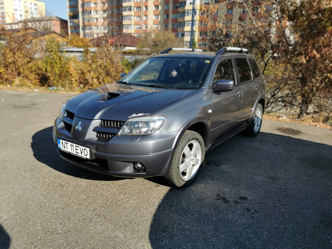

Hi all,
Since a few days ago I'm the (un) happy owner of a O1T. I've bought the car online from abroad, so no test drive before buying :( . Definitely not the recommended way, but I took the risk. Is a German car with 158.000 kilometres. Looks pretty good and not much rust (or at least that I think). I definetly wanted one with little rust, this was my main criteria. I missed a few deals on others cars before this one, so I thought this will be a good buy with my "experience" in O1T area.
Click on pics to enlarge.

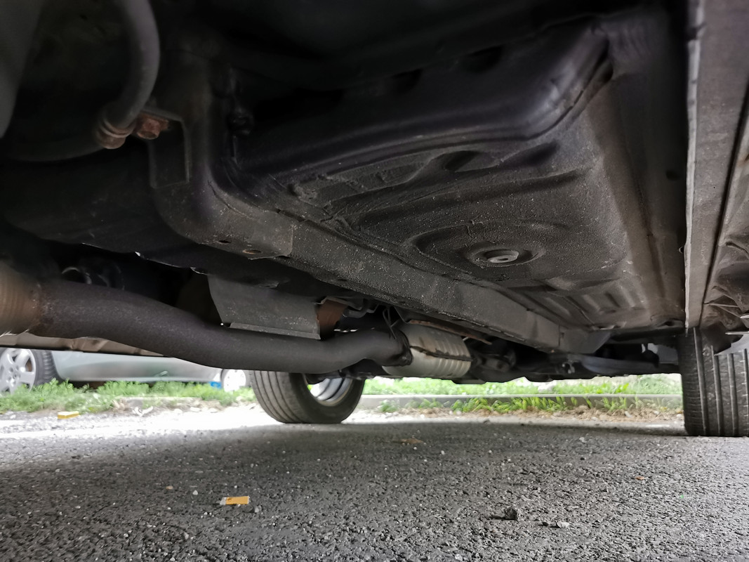

And now the problem that I have. When the car arrived, looked as I expected, no surprises here, but at the first test drive, I've noticed the engine was quite loud, in high RPM it sound like a rocket. After a few kilometres, when I opened the hood, from under exhaust manifold heat shield I saw a little smoke coming out. I knew about cracking exhaust manifold... so today i removed the heat shield. For now I can't see any crack in the manifold, but I have noticed that in left part (cilinder 1) the manifold is definetly more distanced from the engine. So I'm thinking to order a new set of gaskets for now and hope no more surprises when I remove the manifold.
So, what do you think guys? About the car and the exhaust problem. I'm counting on your help to keep this thing running, here in Romania people are brainwashed with german cars myths, so little knowledge abou Japan cars.
Best regards from Piatra Neamt (Romania) :) ,
Constantin

Hello Friend.
I am glad that you finally managed to buy your dream car. You can see signs of tampering with the exhaust manifold. I bet the job wasn't done properly. I think you need to dump the exhaust manifold and process it through planning. Then be sure to put it on the original gasket number: MR323654. No other seals work. If necessary, take care of new pins and nuts. That should silence the rocket :wink:
Take care!

Thanks Bzyk, the car is nice and I hope I'll manage to resolve soon the manifold issue and have it registered. Great advice with planning the monifold, I'll check that too and I will replace the studs and nuts too. I'll post update about the rocket modification :wink: , I hope for a safe landing.

Finally managed to register the car, got an appropriate car registration number :D
