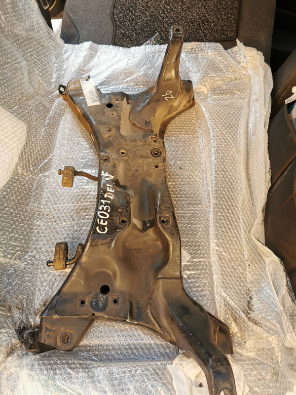

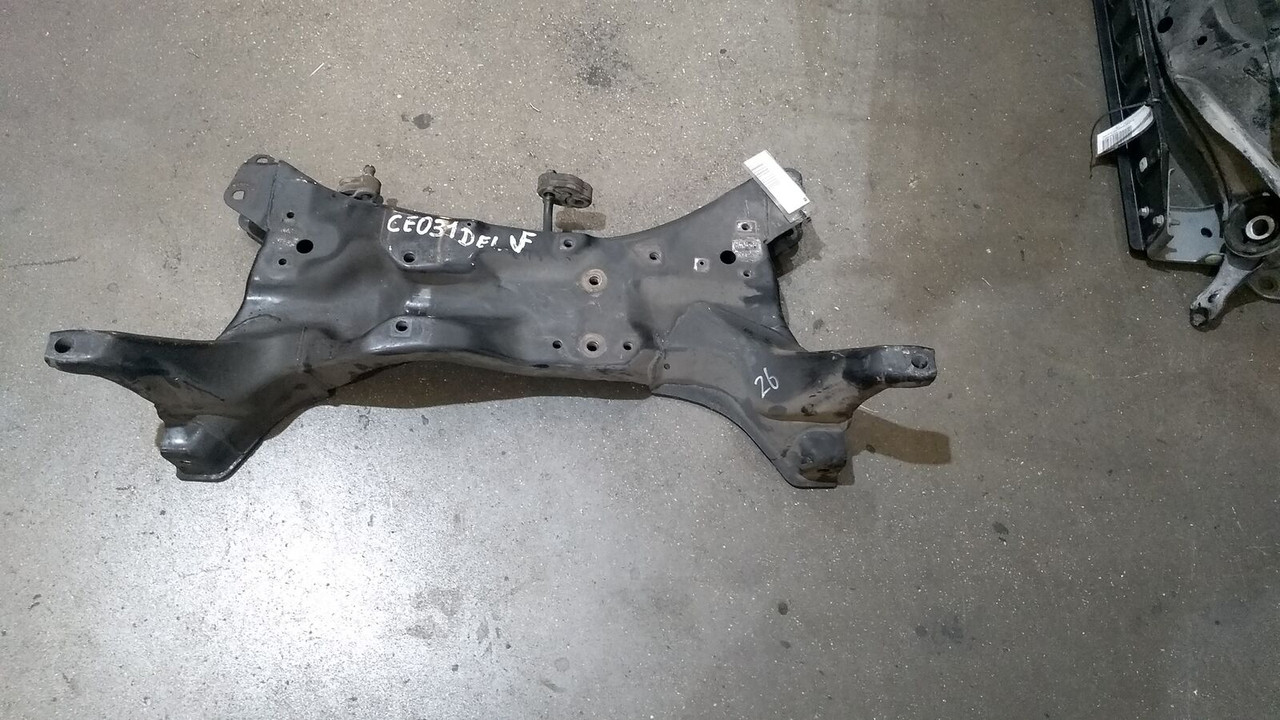

Well, seems I have to do a major renovation of suspension, both front and back... I guess nothing new for a new Outlander owner :evil: . The front CROSSMEMBER is in quite bad shape, so I've found a used original, should be here in few days, from sunny Spain 8) :
the condition of front suspension
the new CROSSMEMBER, used but hopefully no rust - 140 euro shipped seemed like a good deal to me

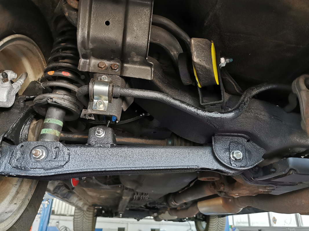

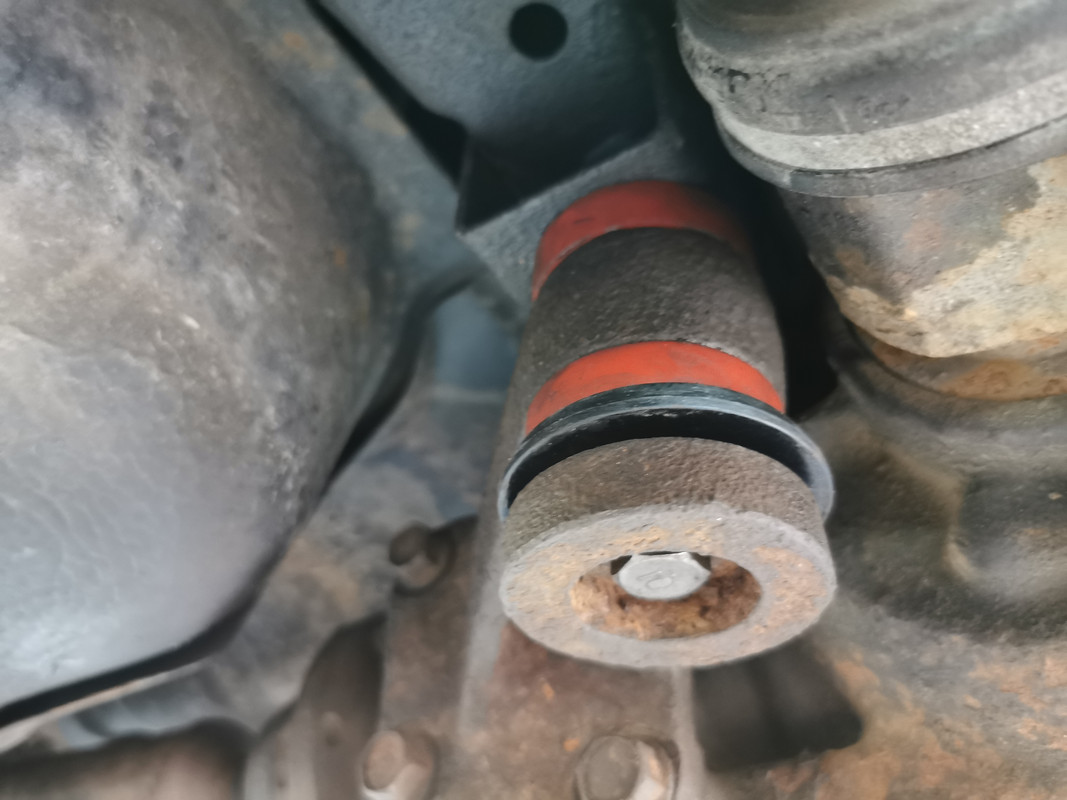

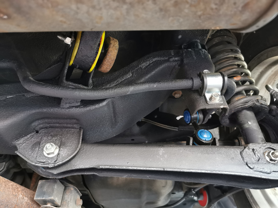

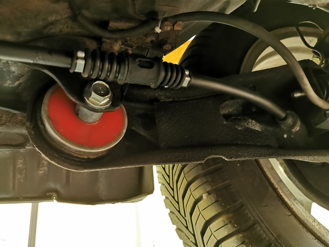

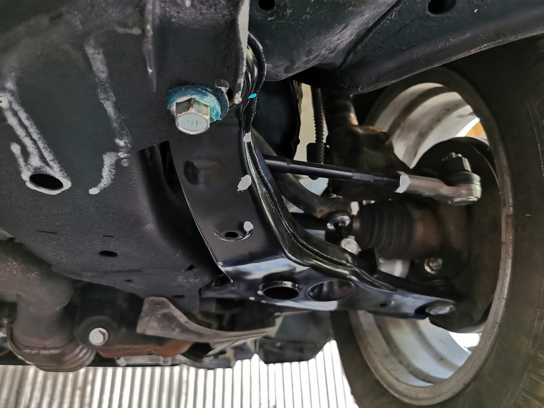

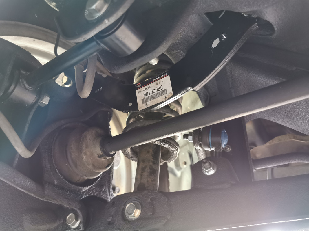

I've finally managed to finish a major restoration of front and back suspension. So let’s review what has been changed:
- front suspension crossmember was replaced with a used one and new suspension arms made by SIDEM. I’ve changed some steering parts too: Tie Rod End 555 SE-B011 + Tie Rod Axle Joint CTR CRM-26 + MB266164 WASHER, STEERING GEAR + SIDEM 371.038 Bellow, steering. New steering fluid Mobil Mobil ATF 320 (1l)
- renovation of back crossmember, cleaning and painting. New OE arms MN100086 + MN100109, OE bushings for lower arm MN100110 + 4113A062. This big bushing, 4120A012, I’ve replaced with poliuretany from olkusz.
- stabilizer bar OE bushings with new brackets and bolts.
- rear differential bushings replaced with poliuretany from olkusz.
- anti-roll bars front and back
- almost all bolts, washers and nuts were replaced with new OE.
Additional I’ve changed the front brakes, with the ones from ASX: almost new OE calipers, Textar discs and pads. For the back, only the parking brake cables and shoes were replaced. New brake fluid Mobil DOT 4 (1l).
All this was pretty expensive, in one visit to workshop I’ve spent around 8.000 PLN for parts and 3.000 PLN labor costs, so in total more than 2K Euro. Yes, it’s a lot of (hard) work to do this, mainly because almost all bolts are seized and most workshops don’t want to do it, they only like easy work. The workshop initially thought it will do it in 2 days, but in the end, it took them 6 days to finish it.

The front crossmember as received from sunny Spain, notice the perfect condition, this has never seen winter road salts!

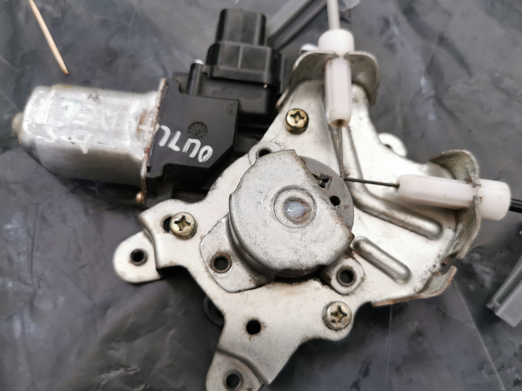

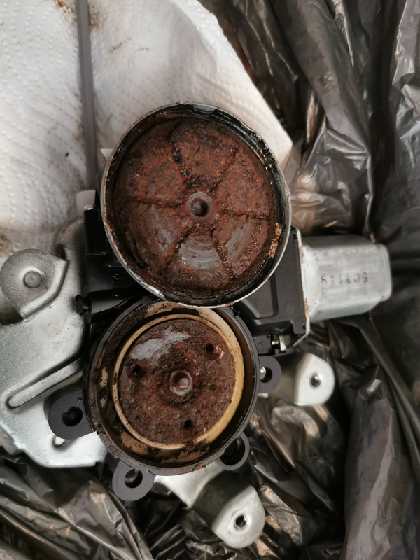

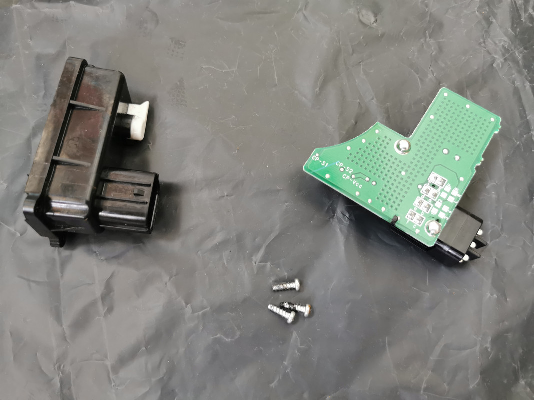

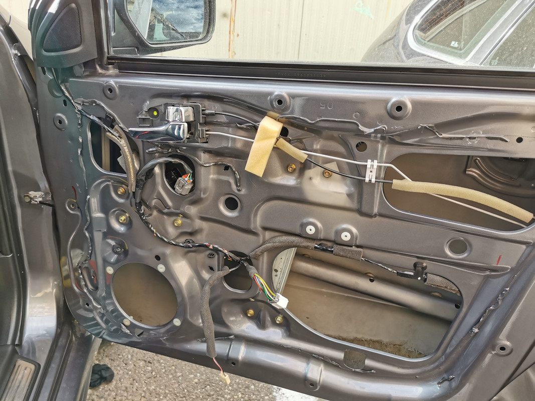

I saw is a common problem with power windows on Outlander 1, my driver door glass was working more down than up lately. So I've decided to open up to see what's wrong. I've bought in advance a mechanism with cable from polcar (5265PSG1), but it turned out than cable was good, the problem was with the motor, I can't believe how much rust was inside :shock: . I've read somewhere that you can swap the back motors with the front ones, so I've bought a pair used from the back. Luckily these proved to be be in excellent condition, no sign of rust inside :) ! To replace the driver side motor, you will have to use the motor from right back (not left!, you swap them in diagonal). The motors are almost identical, the only part you will have to keep is the circuit board that is under 3 screws. I've cleaned and greased everything with silicon grease, sealed with new liquid gasket (Reinzosil), so as a result the power window works like new :) . I think this approach is better than buy used front motors, the back one are usually in better condition, less used and much cheaper.

I did the same thing for right front power window. This one was working fine, but I've decided to check it anyway. Surprisingly the motor was in perfect condition inside, just some rust on outside on the bolt that sends power from the motor to lifting mechanism. I've replaced the motor with the one from the back that I already had, so I should be fine with power windows for a long time, I hope :)

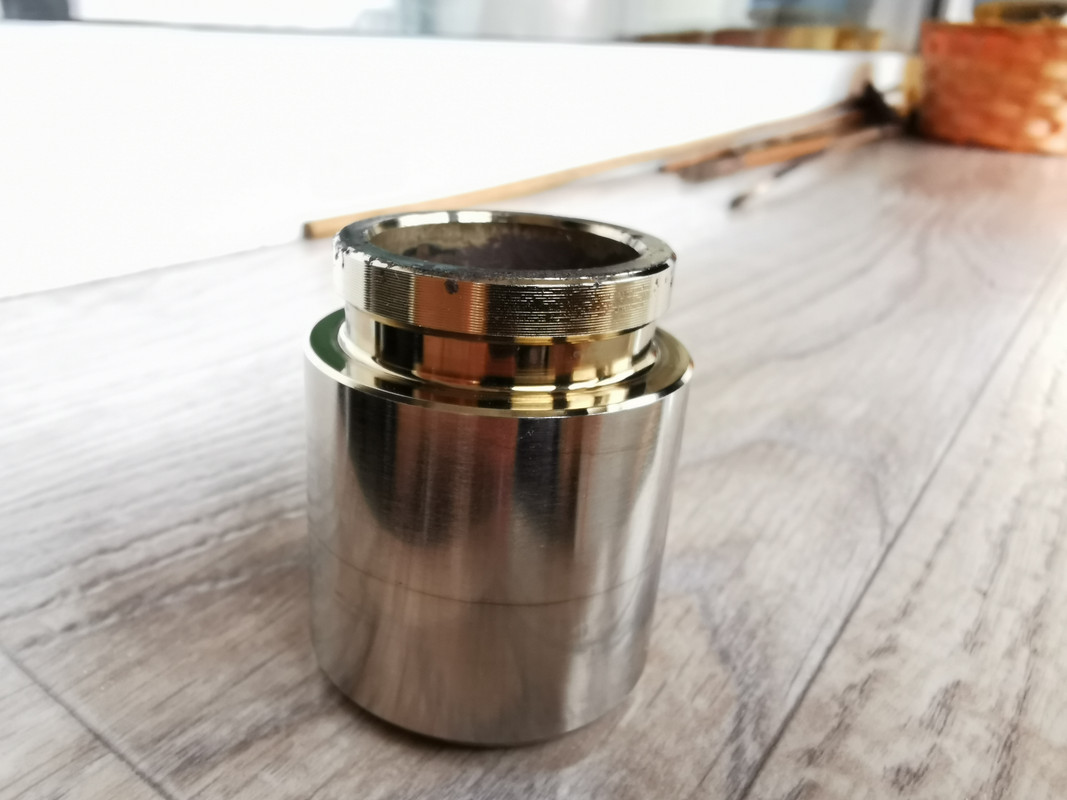

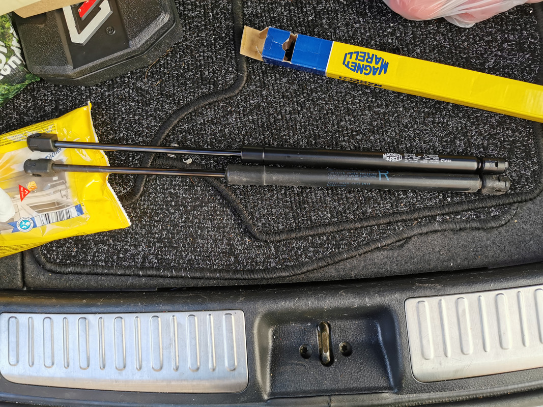

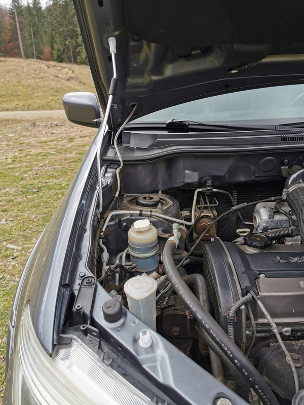

Tail gas springs were pretty tired, so after hitting my head several times on the door I've decided to change them. Plus some other small things like a new hood support.
best_x_treme - 28-01-2023, 18:28
