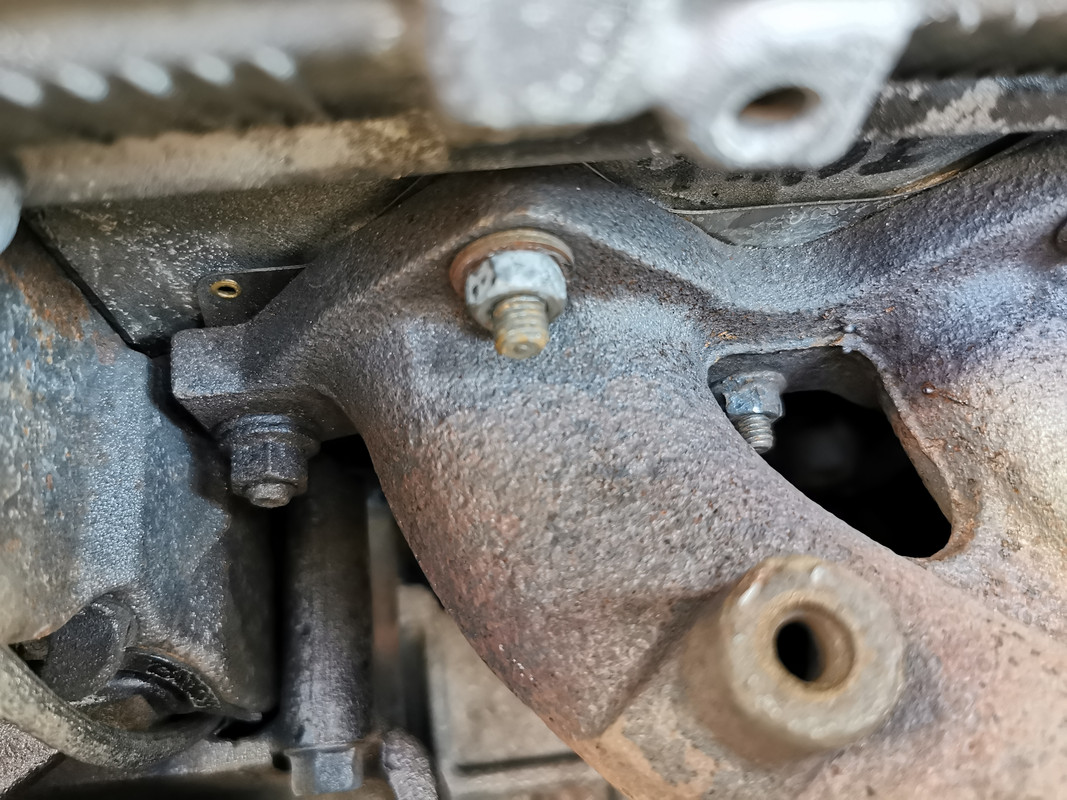

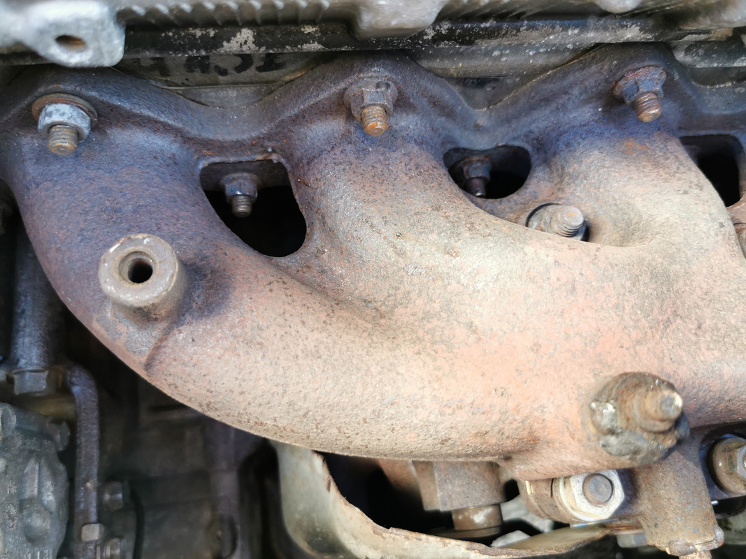

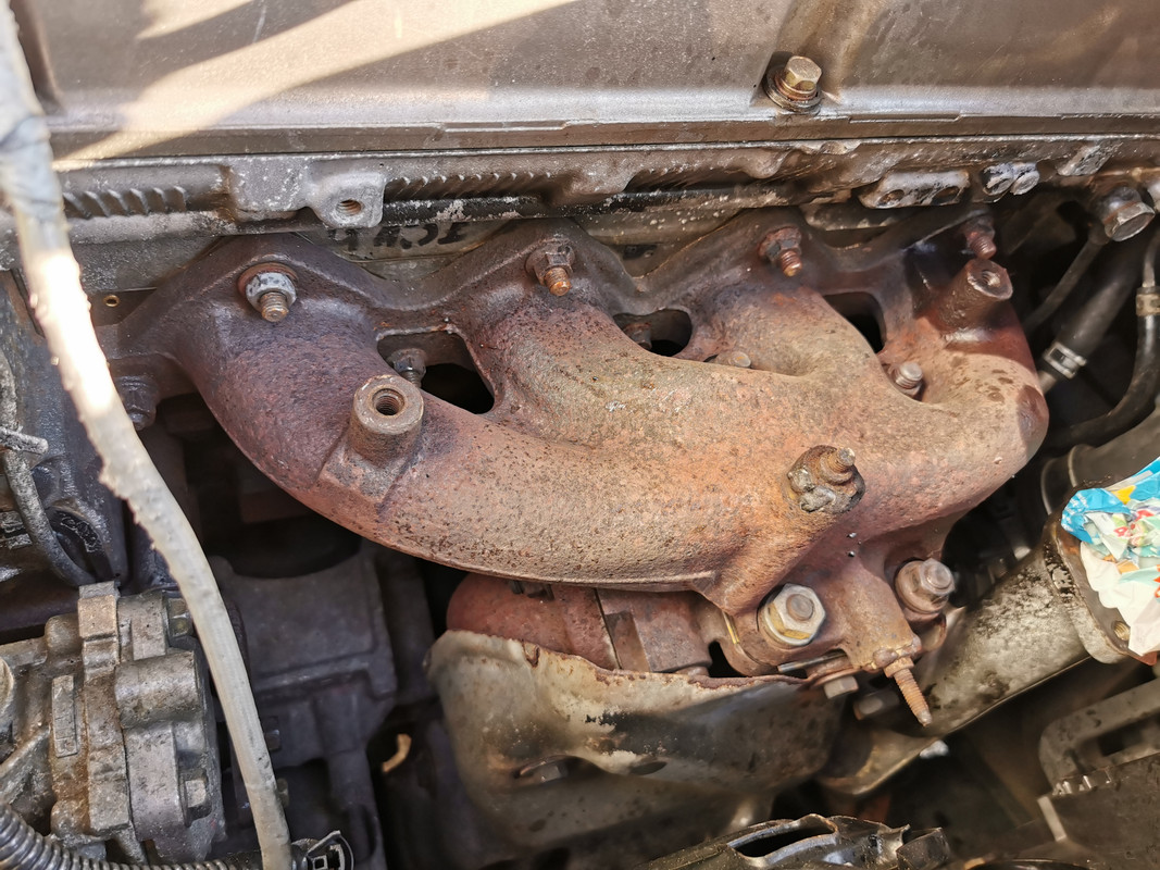

And now the problem that I have. When the car arrived, looked as I expected, no surprises here, but at the first test drive, I've noticed the engine was quite loud, in high RPM it sound like a rocket. After a few kilometres, when I opened the hood, from under exhaust manifold heat shield I saw a little smoke coming out. I knew about cracking exhaust manifold... so today i removed the heat shield. For now I can't see any crack in the manifold, but I have noticed that in left part (cilinder 1) the manifold is definetly more distanced from the engine. So I'm thinking to order a new set of gaskets for now and hope no more surprises when I remove the manifold.

I am glad that you finally managed to buy your dream car. You can see signs of tampering with the exhaust manifold. I bet the job wasn't done properly. I think you need to dump the exhaust manifold and process it through planning. Then be sure to put it on the original gasket number: MR323654. No other seals work. If necessary, take care of new pins and nuts. That should silence the rocket :wink:
Take care!

Thanks Bzyk, the car is nice and I hope I'll manage to resolve soon the manifold issue and have it registered. Great advice with planning the monifold, I'll check that too and I will replace the studs and nuts too. I'll post update about the rocket modification :wink: , I hope for a safe landing.

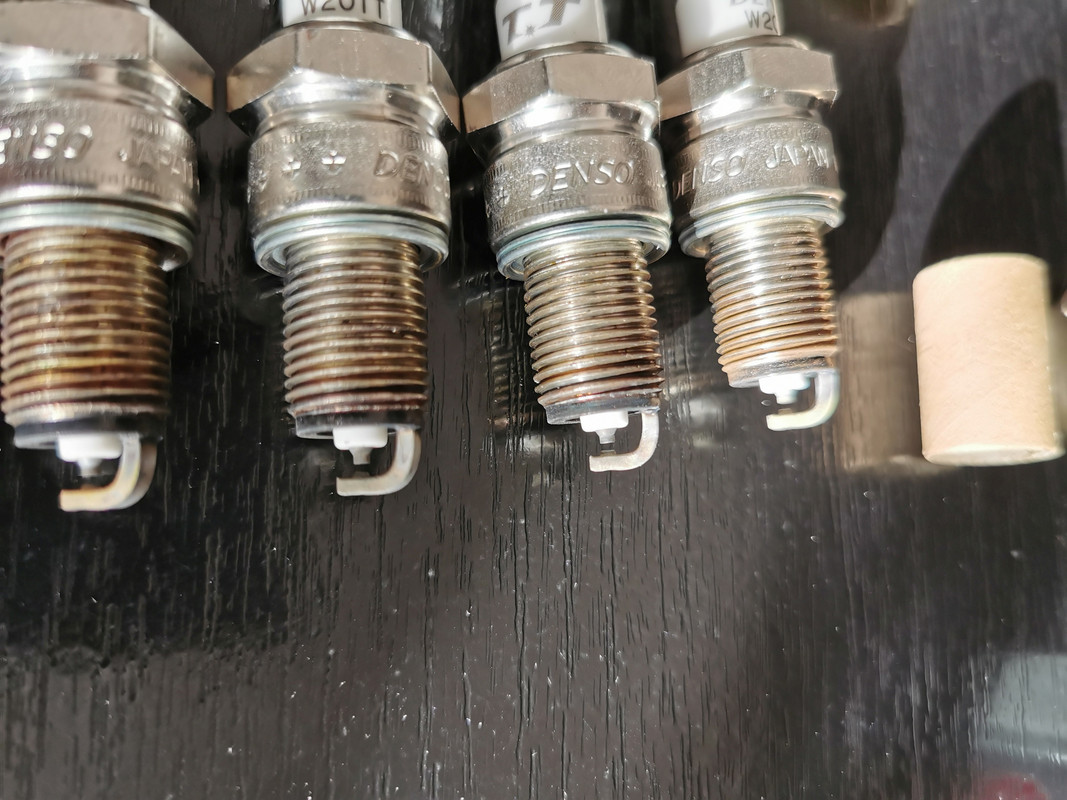

These days I've changed the sparks too. I've put the evo sparks, NGK 3106, as I saw recommended here on forum.
The car had some cheap Denso w20tt sparks, I don't think these were recommended for this car. Anyway, they were looking good and the car was working fine with them.

Świece jak nowe. Mam nadzieję że nowe NGK są produkcji Japońskiej. A kot to się prosi o kłopoty. :wink:

The sparks are made in Japan. I've bought them in a store, for around 15 euro/piece. It seems there are some fakes NGKs, so I would't recommend buy them from sites like ebay.
