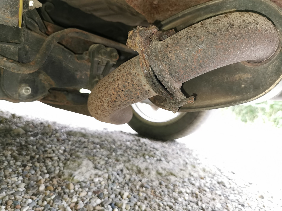

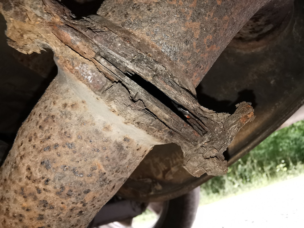

Any idea how to repair this exhaust leak? There are any flanges available to be welded there or have to be custom made? Any tips will be appreciated. Thanks!

cut, clean and use the device bellow - with sealing paste
