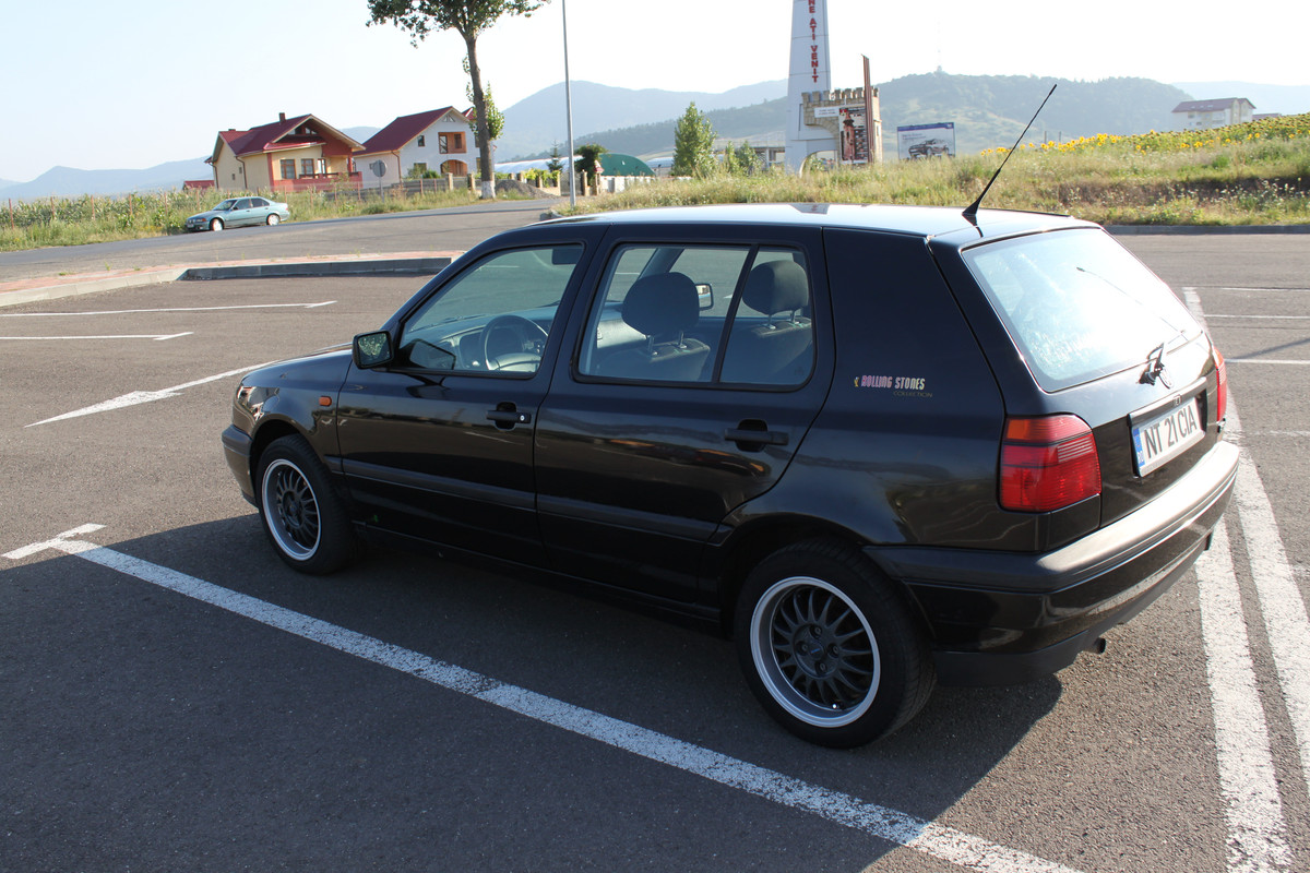

Maybe a bicolor rim? I had something like that on a Golf 3
